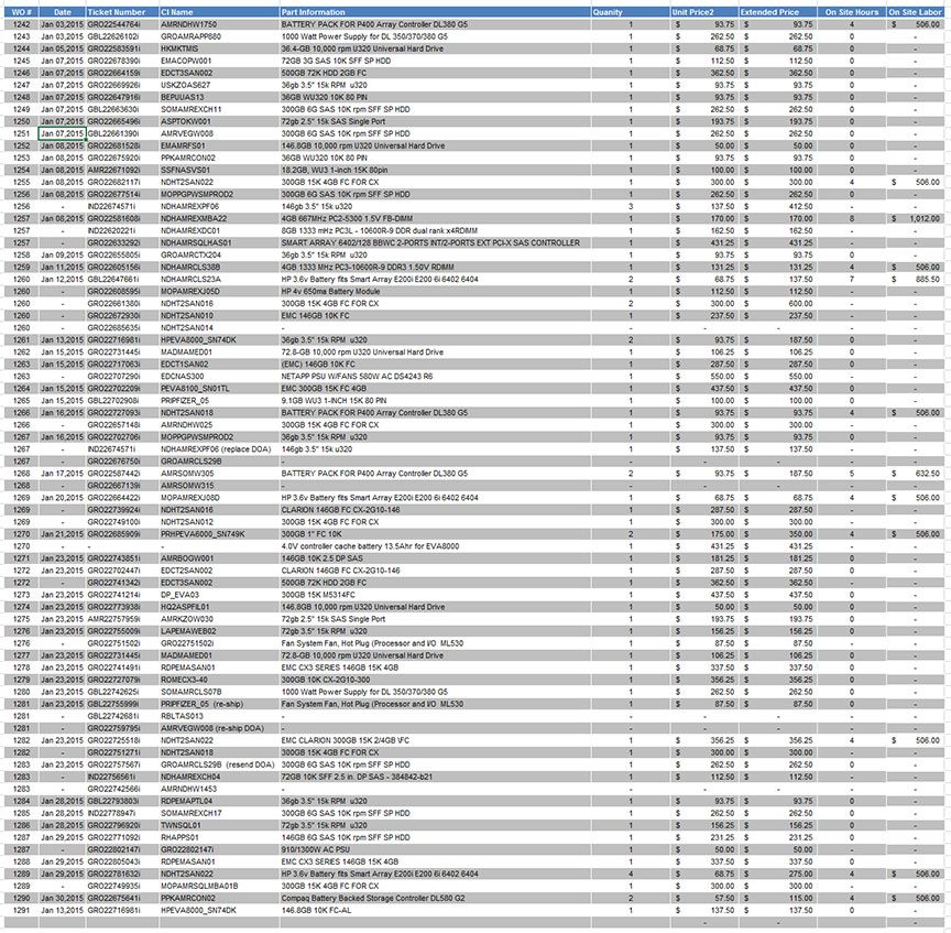

In have a Calculations page and 50+ invoice pages that are almost identical...
I want to calculate on what row a few items start..
Note that invoice worksheet are named 1242, 1243, 1244, etc...
