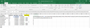

Thank you. instead using xlookup and filter, do you have other method? currently i use excel 2016. i try use xlookup and filter cannot work
If you keep the set-up of the holidays grouped per state, this seems to work:
=NETWORKDAYS.INTL(C2;D2;VLOOKUP(B2;Holiday!$G$2:$H$8;2;FALSE);IFNA(OFFSET(Holiday!A1;MATCH(A2;Holiday!$A$2:$A$7;0);1;COUNTIF(Holiday!$A$2:$A$7;A2));0))

if use this formula let say from start date to end date after holiday or before holiday, Is it this formula will calculate also for countif holiday too? supposedly did not countif in list holiday right? please correct me if i wrong
I see I did a mistake in the offset formula. The starting position needs to be an absolute reference OFFSET(Holiday!$A$1
OFFSET can return a array. In the example of Melaka it returns 2 dates 5/01/2024 and 6/01/2024. Because we have 2x Melaka in the list of hoilidays. Hence the countif used. These days are used in the argument holidays of NETWORKDAYS.INTL function. That function corrects the number of working days taking into account the list of holidays. So if the start and end date are both before or after the holidays will have no effect on the calculation. In that scenario the holidays are simply omitted.

oh i see. may i know, which part need to use for OFFSET(Holiday!$A$1 into this formula ?
=NETWORKDAYS.INTL(C2;D2;VLOOKUP(B2;Holiday!$G$2:$H$8;2;FALSE);IFNA(OFFSET(Holiday!$A$1;MATCH(A2;Holiday!$A$2:$A$7;0);1;COUNTIF(Holiday!$A$2:$A$7;A2));0))

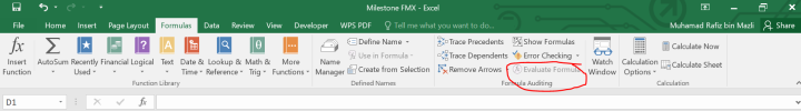

Just to ask, what tool you use ya? excel file or WPS? i check in WPS this tab formula have it.. but in my excel evaluate formula did not active
Did you select the cell, with the formula? Evaluate is on the ribbon since many versions prior to Excel 2016.

For the error, might it be you have to use a comma "," as argument separator in the formula where I have semi-colon ";"?
See #4, you can open that file. Only correct the formula as in #8
