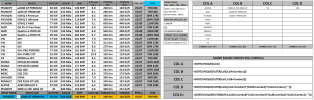

UPDATED files attached (1st picture with workings, and 2nd picture version is SEARCH tab & DATA tab to make it obvious what is source data & results!).
All works, but ideally surely there is short hand version that works exclusively in 21 or 365.

Hello
After some thought since FILTER FUNCTION is either AND or OR, it is likely it best expressed as I've edited it!
It is easy to follow Filter Formula Dynamic Boxes A-D + Blank (P1, X1,AF1,AN1, AV1) as seperates like this, but perhaps there is an even simpler solution!:
DYN 1BOX (A)DATAP1=IF('SEARCH AZ'!A2="","",SORT(FILTER(DATA!A:F,(DATA!A:A='SEARCH AZ'!A2)),2,1))
DYN 2BOX (B)DATAX1=IF('SEARCH AZ'!A2<>0,(SORT(FILTER(DATA!A:F,(DATA!A:A='SEARCH AZ'!A2)*(IF('SEARCH AZ'!B2<>0,(DATA!B:B='SEARCH AZ'!B2)))),3,1)))
DYN 3BOX (C)DATAAF1=IF('SEARCH AZ'!A2<>0,(SORT(FILTER(DATA!A:F,(DATA!A:A='SEARCH AZ'!A2)*(IF('SEARCH AZ'!B2<>0,(DATA!B:B='SEARCH AZ'!B2)*(IF('SEARCH AZ'!C2<>0,(DATA!C:C='SEARCH AZ'!C2)))))),4,1)))
DYN 4BOX (D)DATAAN1=IF('SEARCH AZ'!A2<>0,(SORT(FILTER(DATA!A:F,(DATA!A:A='SEARCH AZ'!A2)*(IF('SEARCH AZ'!B2<>0,(DATA!B:B='SEARCH AZ'!B2)*(IF('SEARCH AZ'!C2<>0,(DATA!C:C='SEARCH AZ'!C2)*(IF('SEARCH AZ'!D2<>"",(DATA!D:D='SEARCH AZ'!D2),"HELLO"))))))),5,1)))
DYN BLANKDATAAV1=IF('SEARCH AZ'!A2<>"","",SORT(FILTER(DATA!A:F,(DATA!A:A<>"MAKE")),1,1))
SRCH DYN IFSRCHA12=UNIQUE(IF(D2<>"",DATA!AN1:AS25,IF(C2<>"",DATA!AF1:AK25,IF(B2<>"",DATA!X1:AC25,IF(A2<>"",DATA!P1:U25,(DATA!AV1:BA25))))))
SRCH NO ZEROSRCHA12SELECT SEARCH RESULTS BELOW HDR: FORMAT CELLS > CUSTOM: 0;-0;;@
Instead of the Nested If alternative of the 4 Dynamic Box selections + if Blank selected, as less obvious of what equals intended!
A:A='SEARCH AZ'!A2)*(IF('SEARCH AZ'!B2<>0,(DATA!B:B='SEARCH AZ'!B2)*(IF('SEARCH AZ'!C2<>0,(DATA!C:C='SEARCH AZ'!C2)*(IF('SEARCH AZ'!D2<>"",(DATA!D:D='SEARCH AZ'!D2),"HELLO"))))))),5,1))),IF($C$2<>"",IF('SEARCH AZ'!A2<>0,(SORT(FILTER(DATA!A:F,(DATA!A:A='SEARCH AZ'!A2)*(IF('SEARCH AZ'!B2<>0,(DATA!B:B='SEARCH AZ'!B2)*(IF('SEARCH AZ'!C2<>0,(DATA!C:C='SEARCH AZ'!C2)))))),4,1))),IF($B$2<>"",IF('SEARCH AZ'!A2<>0,(SORT(FILTER(DATA!A:F,(DATA!A:A='SEARCH AZ'!A2)*(IF('SEARCH AZ'!B2<>0,(DATA!B:B='SEARCH AZ'!B2)))),3,1))),IF($A$2<>"",IF('SEARCH AZ'!A2="","",SORT(FILTER(DATA!A:F,(DATA!A:A='SEARCH AZ'!A2)),2,1)),IF('SEARCH AZ'!A2<>"","",SORT(FILTER(DATA!A:F,(DATA!A:A<>"MAKE")),1,1)))))))
Revised file with smart unique/sort edits attached as 2 Tab: SEARCH AZ & DATA.

Hello still impressed with the SEARCH SEQUENCE version, been looking for a simplified version, currently just 4 COMBOs use in ORDER.
QUESTION: SORT UNIQUE FILTER FORMULA edit simple concise way of COMBO BOXs via INDEPENDENT + MULTI of SPILL RANGEs.
Current NON-INDEPENDENT 4 COMBO BOX FORMULAS:
COMBO1
=SORT(UNIQUE(ColA))
COMBO2
=SORT(UNIQUE(FILTER(ColB,ColA=Combo1)))
COMBO3
=SORT(UNIQUE(FILTER(ColC,ColB=Combo2)))
COMBO4
=SORT(UNIQUE(FILTER(ColD,(ColC=Combo3)*(COLB=Combo2)*(ColA=Combo1),"")))
RESULTS COLUMN E
=SORT(UNIQUE(FILTER(DATA,(ColD=Combo4)*(ColC=Combo3)*(ColB=Combo2)*(ColA=Combo1),"")))
