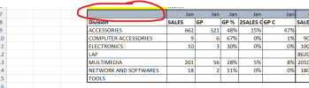

| Question |
| 1. Need to Make a Slicer from Answer Sheet Table By Month Wise, Above Table Came form another Sheet through formula |
| 2.Sample Dummy Slicer Given In D20 Same like Required |
| 3. If We Click "Apr" Button Only Apr Data Came In D25 |
| Question |

This is not a true statement. If you update the source data and then on the Data Tab, select Refresh All (Same Same as if you had a regular Pivot Table) then the output updates. If you want it automatically, then on the data Tab, select Queries and Connections and then click on connections and select update upon opening spreadsheet.While Using Power Query and Pivot There is no Auto Update !.
ThanksThis is not a true statement. If you update the source data and then on the Data Tab, select Refresh All (Same Same as if you had a regular Pivot Table) then the output updates. If you want it automatically, then on the data Tab, select Queries and Connections and then click on connections and select update upon opening spreadsheet.
Pivot tables now have automatic update as a default action (finally).4. If any Data Edit In Data Sheets Then Auto Update In Slicer Linked Table
Question 1. Need to Make a Slicer from Answer Sheet Table By Month Wise, Above Table Came form another Sheet through formula 2.Sample Dummy Slicer Given In D20 Same like Required 3. If We Click "Apr" Button Only Apr Data Came In D25
