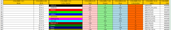

I have a workbook that i made to experiment with to help my coding.
The following code I've been using for some time to give me the column (columns C thru V) number and letter to use in my code. An example follows,
As you can see, I had to write the code for each column. But now I'm wondering if there is a shorten code that will give the same result (see attached example) I can use over multiple column's.
