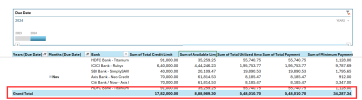

Thank you so much, @vletm for your assistance. Your help gave me some useful insights. To answer your question:
#2 What is connection between Year | Month and Due Date?
It appears there was a typo in the Excel sheet I attached, and I apologize for that the correct value is 2024 as all the data in the excel sheet belongs to the year 2024. The "Year" column represents the year in which the statement was generated, the "Month" column indicates the month of the statement, and the "Due Date" reflects the grace period by which the payment must be made. Therefore, the "Months" column should refer to the statement generation month, not the due date.
Currently, the Grand Total reflects the combined total for both September and October. However, is it possible to see the Grand Total for each month separately. The reason is that the credit limit for a given card typically remains fixed and doesn’t change monthly. Summing the credit limit for both months together doesn't provide any useful insights.
vk7
I would recommend to use dates instead of Year and TEXT-Months.
If Your sample data has that kind of ... then those will always makes more wondering.
>> You could modify Your data and after that modify my made pivot-table and timeline.
Yes ... have You used Pivot-tables before?
... select Pivot-table > From Excel-menu > Design > Subtotals
