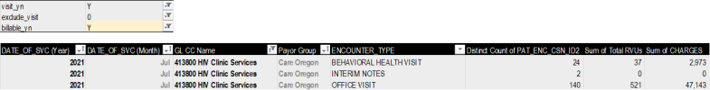

I have an unusual request: I use Distinct Count in Pivot Tables as a field, like this example:
It works great, but using the Distinct Count function requires using the Data Model, which means the underlying data is stored in the file housing the Pivot Table. This is bloating my file size way too much.
